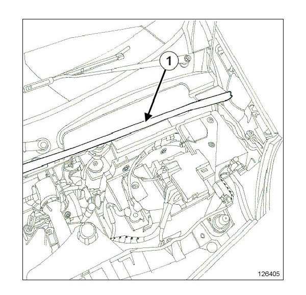

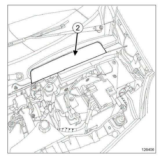

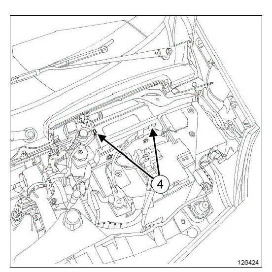

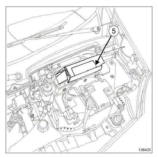

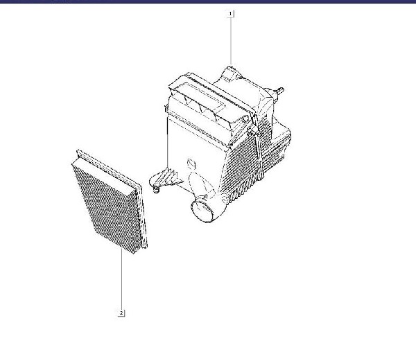

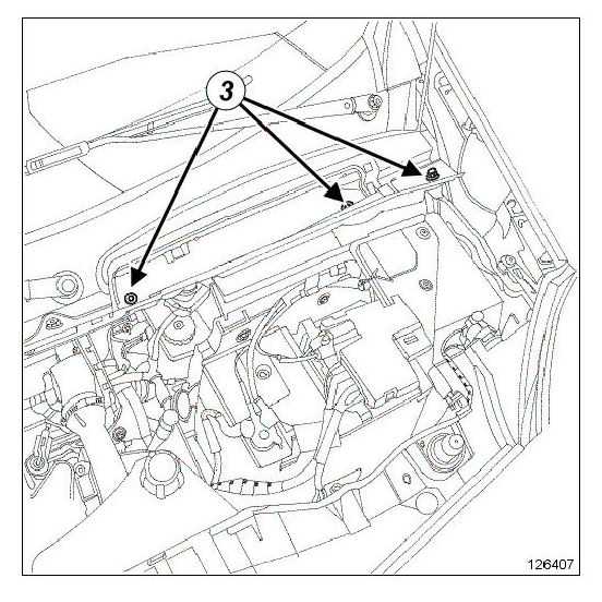

und hier nun auch die Anleitung für den Ausbau des Luftfilter vom k9k
![[image]](images/uploaded/201003041801354b8fe76f7e0f7.jpg)
![[image]](images/uploaded/201003041741114b8fe2a723584.jpg)
![[image]](images/uploaded/201003041743264b8fe32e63f0b.jpg)
![[image]](images/uploaded/201003041743464b8fe342c17c4.jpg)
![[image]](images/uploaded/201003041744024b8fe3521e908.jpg)
![[image]](images/uploaded/201003041809114b8fe9375e528.jpg)

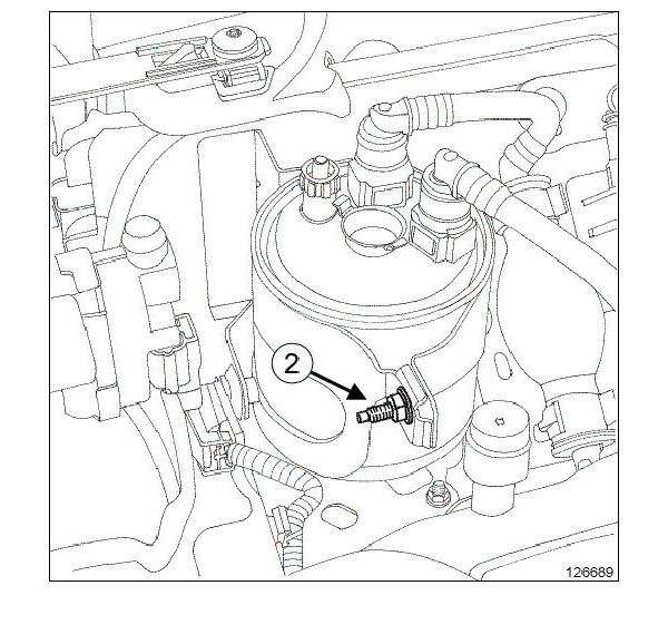

Dieselfilter (mal so zum Spass)
![[image]](images/uploaded/201003041748274b8fe45b3e653.jpg)
